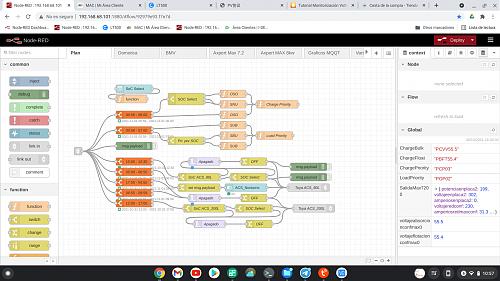

    Gracias! lo que quiero hacer es poder elegir en el deplegable el nivel de SoC de forma que cuando entre el SoC real del BMV, si es menor que el valor definido en el desplegable, el inversor entre 1am y 7am pase a modo de carga SNU y suba intensidad desde 2A hasta 30A...
    Copio flujo:
    Código:
    [{"id":"3b97dabe.d70516","type":"link in","z":"92979e93.f7e7d","name":"Gestion BMV IN","links":["f9b11a5b.95b6a8"],"x":75,"y":880,"wires":[["c1ecaac1.b7a748","25eeb7c0.5f0388","382ae68d.510c2a","925b20ac.60893"]]},{"id":"c1ecaac1.b7a748","type":"time-range-switch","z":"92979e93.f7e7d","name":"","lat":"42","lon":"12","startTime":"00:55","endTime":"07:02","startOffset":"","endOffset":"","x":280,"y":640,"wires":[["da718c30.d6595","6d8e0903.393bb8"],["cb7a5bb5.62c8f8","eae2db66.a15f88","1145872e.675839"]]},{"id":"6d8e0903.393bb8","type":"switch","z":"92979e93.f7e7d","name":"Carga por SOC Extra","property":"payload.SOC","propertyType":"msg","rules":[{"t":"gt","v":"topic.selector","vt":"msg"},{"t":"lt","v":"topic.selector","vt":"msg"},{"t":"lt","v":"30","vt":"num"}],"checkall":"true","repair":false,"outputs":3,"x":240,"y":520,"wires":[["1fde88a8.669967","6ad893c7.2d215c"],["a379ec60.6521","a6d550ac.50aea"],["a379ec60.6521","a6d550ac.50aea"]]},{"id":"1e15ecda.d82403","type":"ui_dropdown","z":"92979e93.f7e7d","name":"","label":"SOC","tooltip":"","place":"Select option","group":"118c40b3.3c7d6f","order":5,"width":0,"height":0,"passthru":true,"multiple":false,"options":[{"label":"soc 70","value":70,"type":"num"},{"label":"soc 50","value":50,"type":"num"}],"payload":"","topic":"topic.selector","topicType":"msg","className":"","x":170,"y":440,"wires":[["6d8e0903.393bb8"]]},{"id":"1fde88a8.669967","type":"function","z":"92979e93.f7e7d","name":"OSO","func":"msg.payload=\"PCP03\"\nreturn msg;","outputs":1,"noerr":0,"initialize":"","finalize":"","libs":[],"x":450,"y":420,"wires":[["bbef6f5.ac5d09"]]},{"id":"6ad893c7.2d215c","type":"function","z":"92979e93.f7e7d","name":"BCh02","func":"msg.payload=\"MUCHGC002\"\nreturn msg;","outputs":1,"noerr":0,"initialize":"","finalize":"","libs":[],"x":450,"y":460,"wires":[["bbef6f5.ac5d09"]]},{"id":"a379ec60.6521","type":"function","z":"92979e93.f7e7d","name":"SNU","func":"msg.payload=\"PCP02\"\nreturn msg;","outputs":1,"noerr":0,"initialize":"","finalize":"","libs":[],"x":810,"y":540,"wires":[["bbef6f5.ac5d09"]]},{"id":"a6d550ac.50aea","type":"function","z":"92979e93.f7e7d","name":"BCh30","func":"msg.payload=\"MUCHGC030\"\nreturn msg;","outputs":1,"noerr":0,"initialize":"","finalize":"","libs":[],"x":810,"y":580,"wires":[["bbef6f5.ac5d09"]]},{"id":"bbef6f5.ac5d09","type":"link out","z":"92979e93.f7e7d","name":"Control BMV OUT","links":["4d2d866e.4d33c8","b08e2dd0.b7e1a","ef3e6756.0ab4c8"],"x":990,"y":460,"wires":[],"l":true},{"id":"118c40b3.3c7d6f","type":"ui_group","name":"Acciones","tab":"402daa81.d7ced4","order":5,"disp":true,"width":"6","collapse":false,"className":""},{"id":"402daa81.d7ced4","type":"ui_tab","name":"Casa","icon":"dashboard","disabled":false,"hidden":false}]
    Esto es otra cosa completamente diferente de lo que estabas pidiendo inicialmente, ves porque hay que concretar las preguntas, me puedo pasar 3 horas haciendo algo inútil si no concretamos bien ¡¡¡Bueno.
    Tienes dos condiciones, la hora, y si el soc , que si es menor del elegido en el desplegable, se toma una decision.
    En el flujo que paso , doy por sentado que el SOC real llega por (msn.paylos.soc) también entiendo que el nodo (time range) es trasparente y permite pasar el msg, y por último no repase tus funciones de control de modo y amperaje, solo las enlace, así que revisarlas antes de poner en producción este flujo.
    Explicación,tienes tres nodos de inyeccion para pruebas, y tienes dos nodos separados del flujo, uno es un dropdown y esta enlazado con una función, esto lo que hace es que guarda en una variable flow (SOCSelec) el valor seleccionado en el desplegable, piensa que es necesario seleccionar un valor antes de que pueda funcionar, y que el alcance de la variable es solo flow, no te funcionara fuera del flujo donde se declara.
    Más tarde en el flujo principal en el (switch) comparo la variable flow (SOCSelec) con él (msg.payload.soc ) que llega de tu flujo si es menor sale por la salida inferior, si es mayor por la superior, y santas pascuas ¡¡ .
    Revisa la lógica, que no sea que lo esté haciendo a la inversa (cosa frecuente en mi) ... y después puedes eliminar los inyectores de pruebas y los nodos debut.
    Código:
    [     {         "id": "c1ed9479090fed94",         "type": "switch",         "z": "836e8b2d1254e558",         "name": "",         "property": "payload.SOC",         "propertyType": "msg",         "rules": [             {                 "t": "gte",                 "v": "SOCSelec",                 "vt": "flow"             },             {                 "t": "lt",                 "v": "SOCSelec",                 "vt": "flow"             }         ],         "checkall": "true",         "repair": false,         "outputs": 2,         "x": 310,         "y": 420,         "wires": [             [                 "e7e967f6e5a7e565",                 "432653bd3da30b9f",                 "01d6ad913d09afe8"             ],             [                 "45980505345587bb",                 "4f5745c411d7f890",                 "575a6d9917101c7e"             ]         ]     },     {         "id": "155a171232448d20",         "type": "inject",         "z": "836e8b2d1254e558",         "name": "SOC 30",         "props": [             {                 "p": "payload.SOC",                 "v": "30",                 "vt": "num"             }         ],         "repeat": "",         "crontab": "",         "once": false,         "onceDelay": 0.1,         "topic": "",         "x": 130,         "y": 360,         "wires": [             [                 "c1ed9479090fed94"             ]         ]     },     {         "id": "e7e967f6e5a7e565",         "type": "debug",         "z": "836e8b2d1254e558",         "name": "",         "active": true,         "tosidebar": true,         "console": false,         "tostatus": false,         "complete": "false",         "statusVal": "",         "statusType": "auto",         "x": 490,         "y": 280,         "wires": []     },     {         "id": "a115e51bdca5a4b5",         "type": "ui_dropdown",         "z": "836e8b2d1254e558",         "name": "",         "label": "",         "tooltip": "",         "place": "Select option",         "group": "b5a59274.ca4dc",         "order": 0,         "width": 0,         "height": 0,         "passthru": true,         "multiple": false,         "options": [             {                 "label": "SOC 40",                 "value": 40,                 "type": "num"             },             {                 "label": "SOC 50",                 "value": 50,                 "type": "num"             },             {                 "label": "SOC 60",                 "value": 60,                 "type": "num"             }         ],         "payload": "",         "topic": "topic",         "topicType": "msg",         "className": "",         "x": 120,         "y": 220,         "wires": [             [                 "f8ebd945315d05b6"             ]         ]     },     {         "id": "f8ebd945315d05b6",         "type": "function",         "z": "836e8b2d1254e558",         "name": "",         "func": "//var SOCSelec = flow.get ('SOCSelec') || 0;\n\nflow.set ('SOCSelec', msg.payload);\nreturn msg;",         "outputs": 1,         "noerr": 0,         "initialize": "",         "finalize": "",         "libs": [],         "x": 120,         "y": 280,         "wires": [             []         ]     },     {         "id": "575a6d9917101c7e",         "type": "debug",         "z": "836e8b2d1254e558",         "name": "",         "active": true,         "tosidebar": true,         "console": false,         "tostatus": false,         "complete": "false",         "statusVal": "",         "statusType": "auto",         "x": 490,         "y": 560,         "wires": []     },     {         "id": "dd80333f24e3a888",         "type": "inject",         "z": "836e8b2d1254e558",         "name": "SOC 40",         "props": [             {                 "p": "payload.SOC",                 "v": "40",                 "vt": "num"             }         ],         "repeat": "",         "crontab": "",         "once": false,         "onceDelay": 0.1,         "topic": "",         "x": 130,         "y": 420,         "wires": [             [                 "c1ed9479090fed94"             ]         ]     },     {         "id": "6fbe8782941845a5",         "type": "inject",         "z": "836e8b2d1254e558",         "name": "SOC 50",         "props": [             {                 "p": "payload.SOC",                 "v": "50",                 "vt": "num"             }         ],         "repeat": "",         "crontab": "",         "once": false,         "onceDelay": 0.1,         "topic": "",         "payloadType": "str",         "x": 130,         "y": 480,         "wires": [             [                 "c1ed9479090fed94"             ]         ]     },     {         "id": "24e27bdd09fd0305",         "type": "link in",         "z": "836e8b2d1254e558",         "name": "Gestion BMV IN",         "links": [             "f9b11a5b.95b6a8"         ],         "x": 55,         "y": 600,         "wires": [             [                 "579a91c8119ff173"             ]         ]     },     {         "id": "579a91c8119ff173",         "type": "time-range-switch",         "z": "836e8b2d1254e558",         "name": "",         "lat": "42",         "lon": "12",         "startTime": "00:55",         "endTime": "07:02",         "startOffset": "",         "endOffset": "",         "x": 190,         "y": 600,         "wires": [             [                 "c1ed9479090fed94"             ],             []         ]     },     {         "id": "432653bd3da30b9f",         "type": "function",         "z": "836e8b2d1254e558",         "name": "OSO",         "func": "msg.payload=\"PCP03\"\nreturn msg;",         "outputs": 1,         "noerr": 0,         "initialize": "",         "finalize": "",         "libs": [],         "x": 470,         "y": 320,         "wires": [             [                 "e83acb8325134b54",                 "526e5648dd36e03a"             ]         ]     },     {         "id": "01d6ad913d09afe8",         "type": "function",         "z": "836e8b2d1254e558",         "name": "BCh02",         "func": "msg.payload=\"MUCHGC002\"\nreturn msg;",         "outputs": 1,         "noerr": 0,         "initialize": "",         "finalize": "",         "libs": [],         "x": 470,         "y": 360,         "wires": [             [                 "e83acb8325134b54",                 "526e5648dd36e03a"             ]         ]     },     {         "id": "45980505345587bb",         "type": "function",         "z": "836e8b2d1254e558",         "name": "SNU",         "func": "msg.payload=\"PCP02\"\nreturn msg;",         "outputs": 1,         "noerr": 0,         "initialize": "",         "finalize": "",         "libs": [],         "x": 470,         "y": 480,         "wires": [             [                 "e83acb8325134b54",                 "dc2ac71a441ad298"             ]         ]     },     {         "id": "4f5745c411d7f890",         "type": "function",         "z": "836e8b2d1254e558",         "name": "BCh30",         "func": "msg.payload=\"MUCHGC030\"\nreturn msg;",         "outputs": 1,         "noerr": 0,         "initialize": "",         "finalize": "",         "libs": [],         "x": 470,         "y": 520,         "wires": [             [                 "e83acb8325134b54",                 "dc2ac71a441ad298"             ]         ]     },     {         "id": "e83acb8325134b54",         "type": "link out",         "z": "836e8b2d1254e558",         "name": "Control BMV OUT",         "links": [             "4d2d866e.4d33c8",             "b08e2dd0.b7e1a",             "ef3e6756.0ab4c8"         ],         "x": 830,         "y": 420,         "wires": [],         "l": true     },     {         "id": "526e5648dd36e03a",         "type": "debug",         "z": "836e8b2d1254e558",         "name": "",         "active": true,         "tosidebar": true,         "console": false,         "tostatus": false,         "complete": "false",         "statusVal": "",         "statusType": "auto",         "x": 810,         "y": 360,         "wires": []     },     {         "id": "dc2ac71a441ad298",         "type": "debug",         "z": "836e8b2d1254e558",         "name": "",         "active": true,         "tosidebar": true,         "console": false,         "tostatus": false,         "complete": "false",         "statusVal": "",         "statusType": "auto",         "x": 810,         "y": 480,         "wires": []     },     {         "id": "b5a59274.ca4dc",         "type": "ui_group",         "name": "Control",         "tab": "402daa81.d7ced4",         "order": 5,         "disp": true,         "width": "6",         "collapse": true,         "className": ""     },     {         "id": "402daa81.d7ced4",         "type": "ui_tab",         "name": "Casa",         "icon": "dashboard",         "disabled": false,         "hidden": false     } ]
    Por cierto el iotawatt que comentabas tiene muy buena pinta... puede ser una buena solución para monitorizar circuitos completos , no serviría para por ejemplo monitorizar la nevera o la lavadora de forma unitaria, porque sus circuitos no suelen ser únicos, en las viviendas se suelen hacer circuitos del tipo .. Potencia cocina, alumbrado general ... enchufes planta uno etc, y para estos casos su puede ser interesante, consumos generales y por circuitos .

    Mil gracias!!!
    Después del tiempo juntos siempre pienso que cuando algo no se entiende (lo que yo describía) es porque no lo había explicado lo suficientemente bien! Disculpa!
    El flujo es perfecto, ya lo tengo integrado y he hecho unas pruebas y funciona de maravilla! Los nodos de tiempo son transparentes, así que el payload.soc fluye sin problemas!
    Había probado mil nodos, pero sin escribir un nodo función era imposible... intenté generar un flow y un topic (que no era lo correcto) pero con tu función va de lujo! He añadido una salida más de seguridad para que sea cual sea la selección nunca baje de 30 (por si alguna vez se queda sin seleccionar).
    Con esta funcionalidad lo que haré será gestionar la batería en invierno, dado que tengo una tarifa muy diferente según los horarios (24cent y 3 cent) por lo que ni siquiera estoy ciclando la batería por las noches... cambio a modo U y ya está. Sólo quiero cargar los días que vea que va a hacer muy malo y tenga consumos altos (calefacción).
    Con el nodo que me has propuesto a ver si monto un selector multiopción y así queda más chulo...
    Respecto al IotaWatt, como los principales consumos los tengo directos al cuadro, creo que podré tomar datos de:
    Red, VE, Frigorifico, Congelador, Horno&Micro, Vitro, Lavadora, Lavavajillas, Panificadora, Plancha y hasta la Thermomix! así que igual uso los 14!!!
    Tengo el nodo de openweathermap que da info cada 3h de los próximos 5 días y que incluye un objeto con el nivel de nubes en escala de 0 a 100... Lo cual en mi caso sería fantástico para mandar un flow SOCSelec (que me has montado) con un nivel u otro... pero ya cacharrearé con el tema!
    Un millón de gracias!

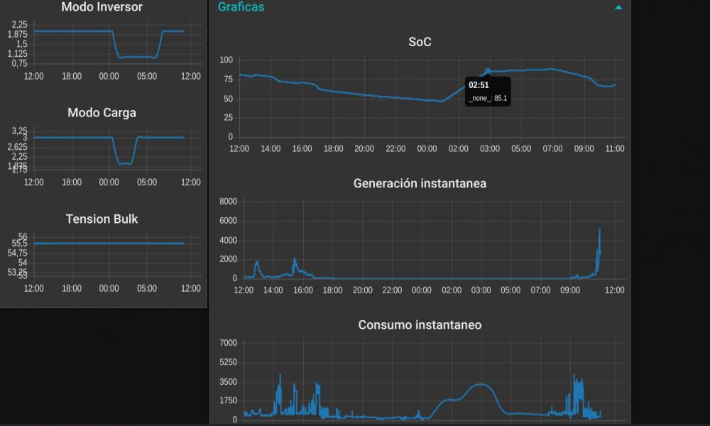

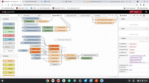

    Hola!
    Llevo unos días sin escribir porque la verdad es que el sistema me estaba dando mil problemas, esta noche ha sido la primera en la que todo ha funcionado. Como ya os comenté mi instalación semiaislada conecta sólo de 1am a 7am a la red para llevar a cabo una rutina de:
    -Cambio de prioridad de cargas de SBU a SUB
    -Carga de coche eléctrico, activando un enchufe Tuya
    -Recarga de batería hasta el 85% de SoC, seleccionable con el desplegable que nos pasó AU (cuando tengo días nublados en el horizonte), cambiando el modo de carga y vigilando el SoC (y ajustando tensión de carga de batería)
    -Recarga de uno de los termos de ACS (cuando acumulo más de 3 días de nubes)
    -Por fuera de nodered, a esas horas conecto una de las bombas de calor para que atempere la casa
    Pues el tema es que las instrucciones enviadas al inversor se ejecutaban con retardo (que era diferente en cada parámetro y cada día), por lo que nada iba fino...

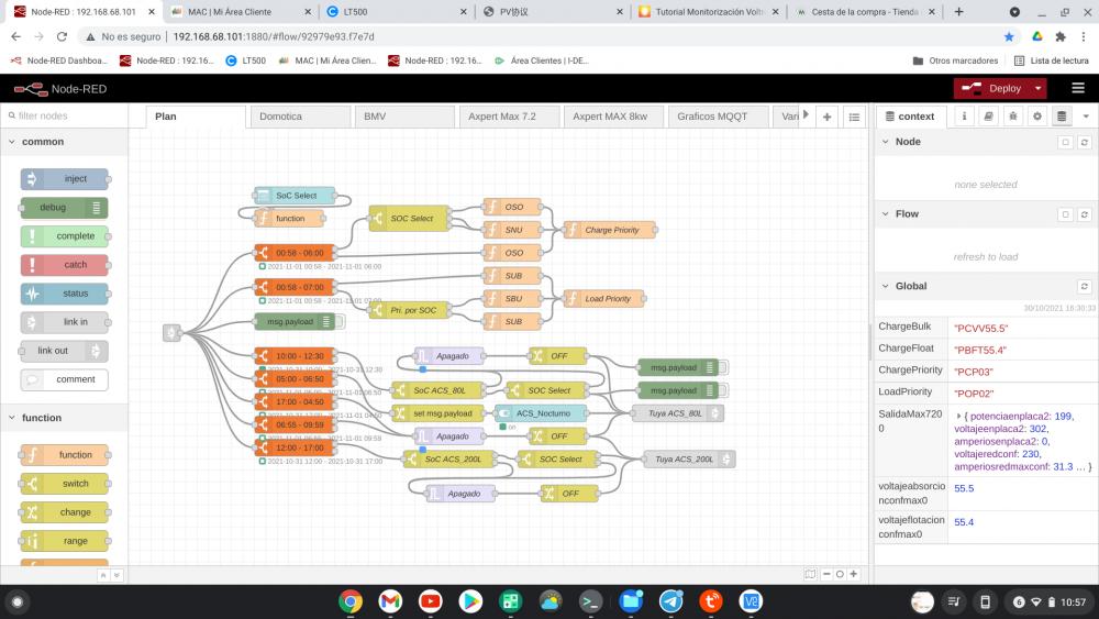

    Solución que hoy ha hecho que todo marche:
    Tutorial Monitorización Voltronic MAX, Nodered, Grafana...-screenshot-2021-10-31-11.00.32.jpg

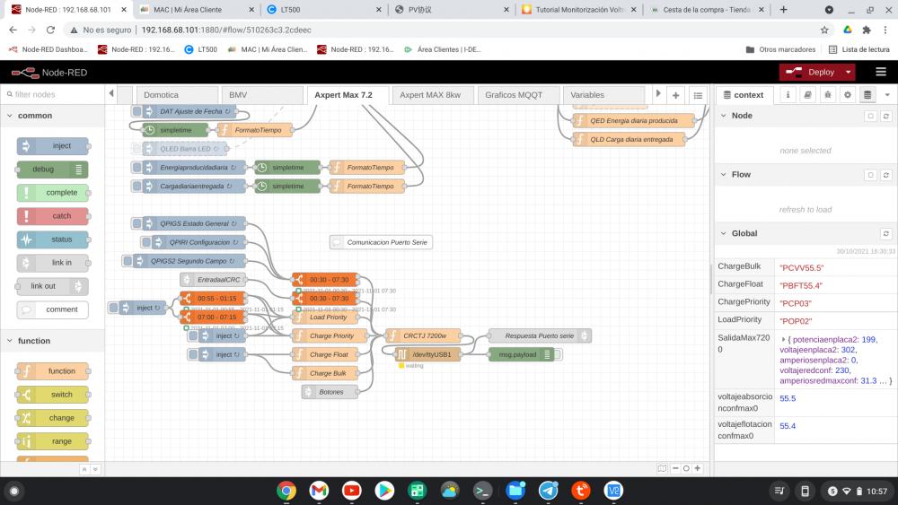

    1. Ajustar el envío de órdenes a través del puerto serie del inversor.
    Tutorial Monitorización Voltronic MAX, Nodered, Grafana...-screenshot-2021-10-31-10.57.36.jpg
    2. Definir en nodered unas variables globales con las que controlar los tempos de inyección de órdenes.
    Tutorial Monitorización Voltronic MAX, Nodered, Grafana...-screenshot-2021-10-31-10.57.48.jpg
    Explicaciones (adjunto los nodos para que se vea mejor):
    1. - Envío de órdenes de lectura de datos al inversor cada 60min, salvo lectura de ciertos parámetros cada 5min, desde la 0:30am a las 7:30am
        - Envío de órdenes de cambio de parámetros al inversor en esa franja temporal sin el "ruido" de continuos requerimientos de lectura que por otro lado son totalmente innecesarios
    Código:
    [{"id":"f4c67433.6ac0f8","type":"comment","z":"510263c3.2cdeec","name":"Comunicacion Puerto Serie","info":"","x":590,"y":780,"wires":[]},{"id":"d237db02.771348","type":"debug","z":"510263c3.2cdeec","name":"","active":false,"tosidebar":true,"console":false,"tostatus":false,"complete":"false","statusVal":"","statusType":"auto","x":890,"y":1020,"wires":[]},{"id":"6a75c1ec.fa49a","type":"link in","z":"510263c3.2cdeec","name":"Botones","links":["5da372bc.32a5ac"],"x":480,"y":1100,"wires":[["8f05adc7.da392"]],"l":true},{"id":"6fbeb1b0.8a304","type":"function","z":"510263c3.2cdeec","name":"Load Priority","func":"msg.payload = global.get ('LoadPriority', msg.payload);\nreturn msg;","outputs":1,"noerr":0,"initialize":"","finalize":"","libs":[],"x":470,"y":940,"wires":[["8f05adc7.da392"]]},{"id":"9ef2a336.d4b07","type":"function","z":"510263c3.2cdeec","name":"Charge Priority","func":"msg.payload = global.get ('ChargePriority', msg.payload);\nreturn msg;","outputs":1,"noerr":0,"initialize":"","finalize":"","libs":[],"x":480,"y":980,"wires":[["8f05adc7.da392"]]},{"id":"b6be9e90.2f2a8","type":"inject","z":"510263c3.2cdeec","name":"","props":[{"p":"payload"},{"p":"topic","vt":"str"}],"repeat":"5","crontab":"","once":false,"onceDelay":0.1,"topic":"","payload":"","payloadType":"str","x":80,"y":920,"wires":[["b0f98eb0.d2cf7","369bc02e.6b22"]]},{"id":"d22d73f4.f0871","type":"function","z":"510263c3.2cdeec","name":"Charge Bulk","func":"msg.payload = global.get ('ChargeBulk', msg.payload);\nreturn msg;","outputs":1,"noerr":0,"initialize":"","finalize":"","libs":[],"x":470,"y":1060,"wires":[["8f05adc7.da392"]]},{"id":"780a9e39.ba77d","type":"function","z":"510263c3.2cdeec","name":"Charge Float","func":"msg.payload = global.get ('ChargeFloat', msg.payload);\nreturn msg;","outputs":1,"noerr":0,"initialize":"","finalize":"","libs":[],"x":470,"y":1020,"wires":[["8f05adc7.da392"]]},{"id":"90b28075.99bee","type":"inject","z":"510263c3.2cdeec","name":"","props":[{"p":"payload"},{"p":"topic","vt":"str"}],"repeat":"47","crontab":"","once":false,"onceDelay":0.1,"topic":"","payload":"","payloadType":"str","x":250,"y":1020,"wires":[["d22d73f4.f0871","780a9e39.ba77d"]]},{"id":"b0f98eb0.d2cf7","type":"time-range-switch","z":"510263c3.2cdeec","name":"","lat":"42","lon":"12","startTime":"00:55","endTime":"01:15","startOffset":"","endOffset":"","x":230,"y":900,"wires":[["6fbeb1b0.8a304","9ef2a336.d4b07"],[]]},{"id":"369bc02e.6b22","type":"time-range-switch","z":"510263c3.2cdeec","name":"","lat":"42","lon":"12","startTime":"07:00","endTime":"07:15","startOffset":"","endOffset":"","x":230,"y":940,"wires":[["6fbeb1b0.8a304","9ef2a336.d4b07"],[]]},{"id":"44886809.e19d78","type":"serial request","z":"510263c3.2cdeec","name":"","serial":"d91892fc.ad91a","x":690,"y":1020,"wires":[["d237db02.771348","85cddabc.4c4538"]]},{"id":"ac4a30f4.5688b","type":"link in","z":"510263c3.2cdeec","name":"EntradaalCRC","links":["1ca333d9.5fedfc"],"x":230,"y":860,"wires":[["8aa753cc.9cffa"]],"l":true},{"id":"8f05adc7.da392","type":"function","z":"510263c3.2cdeec","name":"CRCTJ 7200w","func":"    //  Algoritmo para lanzar los comandos hacia Voltronics con CRC propietario\n    //  Algoritmo realizado por Tejota   \n    var topic = (msg.payload) + (\" \") + (msg.topic); // Topic con el comando string y posible descripcion\n    var comandobuffer = Buffer.from(msg.payload);   // pasando a buffer el string del comando          \n    var crc = 0x0000;                              //  inicio del crc\n    for (tj = 0; tj < comandobuffer.length; tj++)    // scaneo del buffer\n            {\n        const byte = comandobuffer[tj];          // analizando el byte para aplicarle el crc16xmodem\n        tejota = (crc >>> 8) & 0xff;\n        tejota ^= byte & 0xff;\n        tejota ^= tejota >>> 4;\n        crc = (crc << 8) & 0xffff;            //  Algoritmo\n        crc ^= tejota;                       //  crc16 xmodem \n        tejota = (tejota << 5) & 0xffff;    //   sin tabla estatica\n        crc ^= tejota;\n        tejota = (tejota << 7) & 0xffff;\n        crc ^= tejota;\n            }                            // resultante crc numerico \n    var crchexastring = crc.toString(16).padStart(4,'0');  // crc numerico a string hexa añadiendo ceros a izquierda si es preciso\n    var crchexabuffer = Buffer.from(crchexastring, \"hex\"); // buffer del crchexa\n    for (mdk=0; mdk < crchexabuffer.length; mdk++)  // scaneo del buffer\n            {\n            if (crchexabuffer[mdk]==10 || crchexabuffer[mdk]==13 || crchexabuffer[mdk]==40)   // Exceptuando estos bytes mdk \n                    {\n                        crchexabuffer[mdk]++;  // se pone el byte siguiente si es alguno de las excepciones mdk\n                    }\n            }        \n    const retornodecarro = Buffer.from(\"\\r\");\n    var crctotalbuffer = [comandobuffer, crchexabuffer, retornodecarro];  // construyendo el buffer final hacia el hibrido\n    msg.payload = Buffer.concat(crctotalbuffer);\n    msg.topic = topic;\n    return msg;","outputs":1,"noerr":0,"initialize":"","finalize":"","libs":[],"x":680,"y":980,"wires":[["44886809.e19d78"]]},{"id":"85cddabc.4c4538","type":"link out","z":"510263c3.2cdeec","name":"Respuesta Puerto serie","links":["727c0ad6.915784"],"x":930,"y":980,"wires":[],"l":true},{"id":"44e19106.252da","type":"inject","z":"510263c3.2cdeec","name":"","props":[{"p":"payload"},{"p":"topic","vt":"str"}],"repeat":"46","crontab":"","once":false,"onceDelay":0.1,"topic":"","payload":"","payloadType":"str","x":250,"y":980,"wires":[["6fbeb1b0.8a304","9ef2a336.d4b07"]]},{"id":"8aa753cc.9cffa","type":"time-range-switch","z":"510263c3.2cdeec","name":"","lat":"42","lon":"12","startTime":"00:30","endTime":"07:30","startOffset":"","endOffset":"","x":470,"y":900,"wires":[[],["8f05adc7.da392"]]},{"id":"892003a7.a010c","type":"time-range-switch","z":"510263c3.2cdeec","name":"","lat":"42","lon":"12","startTime":"00:30","endTime":"07:30","startOffset":"","endOffset":"","x":470,"y":860,"wires":[["8f05adc7.da392"],[]]},{"id":"a14699cd.7f4cb8","type":"inject","z":"510263c3.2cdeec","name":"QPIGS Estado General","props":[{"p":"payload"},{"p":"topic","vt":"str"}],"repeat":"300","crontab":"","once":false,"onceDelay":0.1,"topic":"Estado General","payload":"QPIGS","payloadType":"str","x":190,"y":740,"wires":[["892003a7.a010c"]]},{"id":"8677dbd4.089408","type":"inject","z":"510263c3.2cdeec","name":"QPIRI Configuracion","props":[{"p":"payload"},{"p":"topic","vt":"str"}],"repeat":"3600","crontab":"","once":false,"onceDelay":0.1,"topic":"Configuracion","payload":"QPIRI","payloadType":"str","x":200,"y":780,"wires":[["892003a7.a010c"]]},{"id":"9495cf67.b4a7b","type":"inject","z":"510263c3.2cdeec","name":"QPIGS2 Segundo Campo","props":[{"p":"payload"},{"p":"topic","vt":"str"}],"repeat":"3600","crontab":"","once":false,"onceDelay":0.1,"topic":"Campo2","payload":"QPIGS2","payloadType":"str","x":180,"y":820,"wires":[["892003a7.a010c"]]},{"id":"d91892fc.ad91a","type":"serial-port","serialport":"/dev/ttyUSB1","serialbaud":"2400","databits":"8","parity":"none","stopbits":"1","waitfor":"","dtr":"none","rts":"none","cts":"none","dsr":"none","newline":"\\n","bin":"false","out":"char","addchar":"","responsetimeout":"1333"}]
    2. Gracias al nodo función que me mandó AU, he definido una variable global para las lecturas y otras para los parámetros clave de gestión del inversor (los copio también)
    Código:
    [{"id":"3b97dabe.d70516","type":"link in","z":"92979e93.f7e7d","name":"Info SoC","links":["f9b11a5b.95b6a8"],"x":75,"y":460,"wires":[["c1ecaac1.b7a748","25eeb7c0.5f0388","382ae68d.510c2a","925b20ac.60893","d0cb0d3e.e711a","202ecb90.ee17e4","9a081cf.e068fe","b22e6138.70e67"]]},{"id":"202ecb90.ee17e4","type":"time-range-switch","z":"92979e93.f7e7d","name":"","lat":"42","lon":"12","startTime":"00:58","endTime":"06:00","startOffset":"","endOffset":"","x":290,"y":320,"wires":[["5b2f462d.d67e78"],["cb7a5bb5.62c8f8"]]},{"id":"c1ecaac1.b7a748","type":"time-range-switch","z":"92979e93.f7e7d","name":"","lat":"42","lon":"12","startTime":"00:58","endTime":"07:00","startOffset":"","endOffset":"","x":290,"y":380,"wires":[["da718c30.d6595"],["eae2db66.a15f88"]]},{"id":"692e1f94.8deb7","type":"function","z":"92979e93.f7e7d","name":"","func":"//var SOCSelec = flow.get ('SOCSelec') || 0;\n\nflow.set ('SOCSelec', msg.payload);\nreturn msg;","outputs":1,"noerr":0,"initialize":"","finalize":"","libs":[],"x":280,"y":260,"wires":[[]]},{"id":"da4c9e6a.b0d4a","type":"ui_dropdown","z":"92979e93.f7e7d","name":"","label":"SoC Select","tooltip":"","place":"Select option","group":"118c40b3.3c7d6f","order":1,"width":0,"height":0,"passthru":true,"multiple":false,"options":[{"label":"SOC 30","value":30,"type":"num"},{"label":"SOC 65","value":65,"type":"num"},{"label":"SOC 85","value":85,"type":"num"}],"payload":"","topic":"topic","topicType":"msg","className":"","x":290,"y":220,"wires":[["692e1f94.8deb7"]]},{"id":"5b2f462d.d67e78","type":"switch","z":"92979e93.f7e7d","name":"SOC Select","property":"payload.SOC","propertyType":"msg","rules":[{"t":"gte","v":"SOCSelec","vt":"flow"},{"t":"lt","v":"SOCSelec","vt":"flow"},{"t":"lt","v":"30","vt":"num"}],"checkall":"true","repair":false,"outputs":3,"x":490,"y":260,"wires":[["7080fe21.da473"],["3aefb4e5.5c9b2c"],["3aefb4e5.5c9b2c"]]},{"id":"eae2db66.a15f88","type":"switch","z":"92979e93.f7e7d","name":"Pri. por SOC","property":"payload.SOC","propertyType":"msg","rules":[{"t":"gt","v":"20","vt":"num"},{"t":"lt","v":"15","vt":"num"}],"checkall":"true","repair":false,"outputs":2,"x":490,"y":420,"wires":[["28351fca.9335e"],["cf46f63a.1e4418"]]},{"id":"cf46f63a.1e4418","type":"function","z":"92979e93.f7e7d","name":"SUB","func":"msg.payload=\"POP01\"\nreturn msg;","outputs":1,"noerr":0,"initialize":"","finalize":"","libs":[],"x":670,"y":440,"wires":[["79e7e41b.94da2c"]]},{"id":"28351fca.9335e","type":"function","z":"92979e93.f7e7d","name":"SBU","func":"msg.payload=\"POP02\"\nreturn msg;","outputs":1,"noerr":0,"initialize":"","finalize":"","libs":[],"x":670,"y":400,"wires":[["79e7e41b.94da2c"]]},{"id":"da718c30.d6595","type":"function","z":"92979e93.f7e7d","name":"SUB","func":"msg.payload=\"POP01\"\nreturn msg;","outputs":1,"noerr":0,"initialize":"","finalize":"","libs":[],"x":670,"y":360,"wires":[["79e7e41b.94da2c"]]},{"id":"cb7a5bb5.62c8f8","type":"function","z":"92979e93.f7e7d","name":"OSO","func":"msg.payload=\"PCP03\"\nreturn msg;","outputs":1,"noerr":0,"initialize":"","finalize":"","libs":[],"x":670,"y":320,"wires":[["54c1e2.5f6c4e2"]]},{"id":"3aefb4e5.5c9b2c","type":"function","z":"92979e93.f7e7d","name":"SNU","func":"msg.payload=\"PCP02\"\nreturn msg;","outputs":1,"noerr":0,"initialize":"","finalize":"","libs":[],"x":670,"y":280,"wires":[["54c1e2.5f6c4e2"]]},{"id":"7080fe21.da473","type":"function","z":"92979e93.f7e7d","name":"OSO","func":"msg.payload=\"PCP03\"\nreturn msg;","outputs":1,"noerr":0,"initialize":"","finalize":"","libs":[],"x":670,"y":240,"wires":[["54c1e2.5f6c4e2"]]},{"id":"54c1e2.5f6c4e2","type":"function","z":"92979e93.f7e7d","name":"Charge Priority","func":"//var ChargePriority = global.get ('ChargePriority' || 0;\n\nglobal.set ('ChargePriority', msg.payload);\nreturn msg;","outputs":1,"noerr":0,"initialize":"","finalize":"","libs":[],"x":840,"y":280,"wires":[[]]},{"id":"79e7e41b.94da2c","type":"function","z":"92979e93.f7e7d","name":"Load Priority","func":"//var LoadPriority = global.get ('LoadPriority' || 0;\n\nglobal.set ('LoadPriority', msg.payload);\nreturn msg;","outputs":1,"noerr":0,"initialize":"","finalize":"","libs":[],"x":830,"y":400,"wires":[[]]},{"id":"118c40b3.3c7d6f","type":"ui_group","name":"Acciones","tab":"402daa81.d7ced4","order":6,"disp":true,"width":"6","collapse":false,"className":""},{"id":"402daa81.d7ced4","type":"ui_tab","name":"Casa","icon":"dashboard","disabled":false,"hidden":false}]
    Código:
    [{"id":"f2d6f5f0.bab578","type":"link in","z":"216f217c.94c8ee","name":"MAX7200","links":["e2947a2c.07c2b8"],"x":100,"y":220,"wires":[["db8b8d30.c4daa","db654944.1bbb48"]],"l":true},{"id":"db8b8d30.c4daa","type":"debug","z":"216f217c.94c8ee","name":"","active":false,"tosidebar":true,"console":false,"tostatus":false,"complete":"false","statusVal":"","statusType":"auto","x":290,"y":160,"wires":[]},{"id":"96813aaa.ba0968","type":"debug","z":"216f217c.94c8ee","name":"","active":true,"tosidebar":true,"console":false,"tostatus":false,"complete":"false","statusVal":"","statusType":"auto","x":530,"y":220,"wires":[]},{"id":"db654944.1bbb48","type":"function","z":"216f217c.94c8ee","name":"SalidaMax7200","func":"//var SalidaMax7200 = global.get ('SalidaMax7200' || 0;\n\nglobal.set ('SalidaMax7200', msg.payload);\nreturn msg;","outputs":1,"noerr":0,"initialize":"","finalize":"","libs":[],"x":300,"y":220,"wires":[["96813aaa.ba0968"]]},{"id":"e3f92e98.f41e4","type":"function","z":"216f217c.94c8ee","name":"SalidaMax7200","func":"msg.payload = global.get ('SalidaMax7200', msg.payload);\nreturn msg;","outputs":1,"noerr":0,"initialize":"","finalize":"","libs":[],"x":300,"y":280,"wires":[["d84ea6e4.607848"]]},{"id":"1e9cf6b9.a00ad9","type":"inject","z":"216f217c.94c8ee","name":"","props":[{"p":"payload"},{"p":"topic","vt":"str"}],"repeat":"5","crontab":"","once":false,"onceDelay":0.1,"topic":"","payload":"","payloadType":"str","x":130,"y":280,"wires":[["e3f92e98.f41e4"]]},{"id":"d84ea6e4.607848","type":"debug","z":"216f217c.94c8ee","name":"","active":true,"tosidebar":true,"console":false,"tostatus":false,"complete":"false","statusVal":"","statusType":"auto","x":530,"y":280,"wires":[]}]
    Mi siguiente paso va a ser montar el nuevo cuadro donde con un shelly voy a controlar un contactor que acople a la red de 1am a 7am de forma que pueda estar completamente offgrid el resto del día salvo que el SoC caiga momento en el que se abrirá de nuevo el contactor.
    Siguiendo con el tema, si dejo Node Red corriendo en una rasp con una micro SD y en la otra con el disco SSD pongo Influx y Grafana, cómo lo veis? La publicación de información entiendo que lo mejor sería hacerla con publicaciones MQTT desde la Rasp que corre Node Red y la suscripciones MQTT desde la otra donde se grabarán en Influx

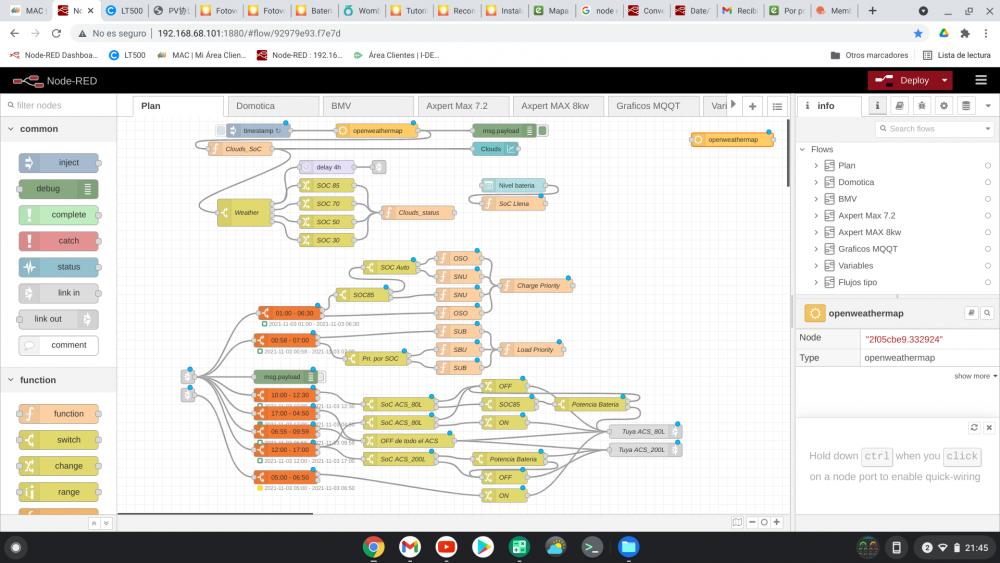

    Hola!
    Sigo cosechando satisfacciones con el Node Red, gracias a la ayuda que me habéis dado... sigo automatizando elementos. Os comparto el flujo para carga nocturna (de 1am a 7am) de batería (tarifa de 3cents/kwh) en función de la nubosidad esperada al día siguiente (mantengo la posibilidad de realizar una carga al 85% para emergencias de forma seleccionable).
    - Nodo Openweathermap (con google maps podéis poner las coordenadas exactas de la instalación)
    - Algoritmo muy sencillo (simplemente sumo el porcentaje de nubes de las 10am, 1pm y 4pm, que las entrega el nodo, y la inyección de consulta la hago a la 1am). Con dicha suma obtengo un valor que convierto en 4 niveles predeterminados de SoC, que es la variable clave en el flujo de gestión nocturna.
    - Adicionalmente los días muy nubosos, se realiza una carga de ACS del termo de uso diario.
    Código:
    [{"id":"9a6fbf85.8127e","type":"openweathermap","z":"92979e93.f7e7d","name":"","wtype":"forecast","lon":"1","lat":"1","city":"","country":"","language":"es","x":570,"y":60,"wires":[["25e26388.341cac","b46df784.7a6328"]]},{"id":"f1abc6f8.5080d8","type":"inject","z":"92979e93.f7e7d","name":"","props":[{"p":"payload"},{"p":"topic","vt":"str"}],"repeat":"","crontab":"*/10 1 * * *","once":false,"onceDelay":0.1,"topic":"","payload":"","payloadType":"date","x":310,"y":60,"wires":[["9a6fbf85.8127e"]]},{"id":"25e26388.341cac","type":"function","z":"92979e93.f7e7d","name":"Clouds_SoC","func":"msg.topic = \"Clouds\"\nmsg.payload = \n{\n    \"Clouds_total\": msg.payload[2].clouds.all + msg.payload[3].clouds.all + msg.payload[4].clouds.all,\n}\nmsg.payload = msg.payload.Clouds_total;\nreturn msg;\n","outputs":1,"noerr":0,"initialize":"","finalize":"","libs":[],"x":270,"y":100,"wires":[["788971f5.2bbdb","8eb7fe4d.5e089"]]},{"id":"788971f5.2bbdb","type":"switch","z":"92979e93.f7e7d","name":"Weather","property":"payload","propertyType":"msg","rules":[{"t":"gt","v":"225","vt":"num"},{"t":"gt","v":"200","vt":"str"},{"t":"gt","v":"100","vt":"num"},{"t":"lt","v":"100","vt":"num"}],"checkall":"true","repair":false,"outputs":4,"x":280,"y":240,"wires":[["f54bd88.2589228","7c73e006.ee82a"],["1568ccc6.ca9643"],["48b85673.7951b8"],["60892da4.04ddd4"]]},{"id":"60892da4.04ddd4","type":"change","z":"92979e93.f7e7d","name":"SOC 30","rules":[{"t":"set","p":"payload","pt":"msg","to":"30","tot":"num"}],"action":"","property":"","from":"","to":"","reg":false,"x":460,"y":300,"wires":[["c738026f.b7055"]]},{"id":"48b85673.7951b8","type":"change","z":"92979e93.f7e7d","name":"SOC 50","rules":[{"t":"set","p":"payload","pt":"msg","to":"50","tot":"num"}],"action":"","property":"","from":"","to":"","reg":false,"x":460,"y":260,"wires":[["c738026f.b7055"]]},{"id":"f54bd88.2589228","type":"change","z":"92979e93.f7e7d","name":"SOC 85","rules":[{"t":"set","p":"payload","pt":"msg","to":"85","tot":"num"}],"action":"","property":"","from":"","to":"","reg":false,"x":460,"y":180,"wires":[["c738026f.b7055"]]},{"id":"c738026f.b7055","type":"function","z":"92979e93.f7e7d","name":"Clouds_status","func":"//var Clouds_status = flow.get ('Clouds_status') || 0;\n\nflow.set ('Clouds_status', msg.payload);\nreturn msg;","outputs":1,"noerr":0,"initialize":"","finalize":"","libs":[],"x":660,"y":240,"wires":[[]]},{"id":"1568ccc6.ca9643","type":"change","z":"92979e93.f7e7d","name":"SOC 70","rules":[{"t":"set","p":"payload","pt":"msg","to":"70","tot":"num"}],"action":"","property":"","from":"","to":"","reg":false,"x":460,"y":220,"wires":[["c738026f.b7055"]]},{"id":"8eb7fe4d.5e089","type":"ui_chart","z":"92979e93.f7e7d","name":"","group":"b5a59274.ca4dc","order":13,"width":"6","height":"3","label":"Clouds","chartType":"line","legend":"false","xformat":"HH:mm","interpolate":"bezier","nodata":"","dot":false,"ymin":"0","ymax":"300","removeOlder":"1","removeOlderPoints":"","removeOlderUnit":"86400","cutout":0,"useOneColor":false,"useUTC":false,"colors":["#1f77b4","#aec7e8","#ff7f0e","#2ca02c","#98df8a","#d62728","#ff9896","#9467bd","#c5b0d5"],"outputs":1,"useDifferentColor":false,"className":"","x":830,"y":100,"wires":[[]]},{"id":"b46df784.7a6328","type":"debug","z":"92979e93.f7e7d","name":"","active":true,"tosidebar":true,"console":false,"tostatus":false,"complete":"false","statusVal":"","statusType":"auto","x":850,"y":60,"wires":[]},{"id":"97547251.5e202","type":"link out","z":"92979e93.f7e7d","name":"Nuboso ACS","links":["f11c4e86.a454c","5f06519b.d6615"],"x":575,"y":140,"wires":[]},{"id":"7c73e006.ee82a","type":"delay","z":"92979e93.f7e7d","name":"","pauseType":"delay","timeout":"4","timeoutUnits":"hours","rate":"1","nbRateUnits":"1","rateUnits":"second","randomFirst":"1","randomLast":"5","randomUnits":"seconds","drop":false,"x":460,"y":140,"wires":[["97547251.5e202"]]},{"id":"35c01e11.5feda2","type":"ui_dropdown","z":"92979e93.f7e7d","name":"","label":"Nivel bateria","tooltip":"","place":"Select option","group":"118c40b3.3c7d6f","order":1,"width":0,"height":0,"passthru":true,"multiple":false,"options":[{"label":"Auto","value":10,"type":"num"},{"label":"Llena","value":85,"type":"num"}],"payload":"","topic":"topic","topicType":"msg","className":"","x":870,"y":180,"wires":[["c7227362.74fb6"]]},{"id":"c7227362.74fb6","type":"function","z":"92979e93.f7e7d","name":"SoC Llena","func":"//var SOC85 = flow.get ('SOC85') || 0;\n\nflow.set ('SOC85', msg.payload);\nreturn msg;","outputs":1,"noerr":0,"initialize":"","finalize":"","libs":[],"x":870,"y":220,"wires":[[]]},{"id":"b5a59274.ca4dc","type":"ui_group","name":"Control","tab":"402daa81.d7ced4","order":7,"disp":true,"width":"6","collapse":true,"className":""},{"id":"118c40b3.3c7d6f","type":"ui_group","name":"Acciones","tab":"402daa81.d7ced4","order":8,"disp":true,"width":"6","collapse":false,"className":""},{"id":"402daa81.d7ced4","type":"ui_tab","name":"Casa","icon":"dashboard","disabled":false,"hidden":false}]
    Código:
    [{"id":"c1ecaac1.b7a748","type":"time-range-switch","z":"92979e93.f7e7d","name":"","lat":"42","lon":"12","startTime":"00:58","endTime":"07:00","startOffset":"","endOffset":"","x":350,"y":800,"wires":[["da718c30.d6595"],["eae2db66.a15f88"]]},{"id":"da718c30.d6595","type":"function","z":"92979e93.f7e7d","name":"SUB","func":"msg.payload=\"POP01\"\nreturn msg;","outputs":1,"noerr":0,"initialize":"","finalize":"","libs":[],"x":730,"y":780,"wires":[["79e7e41b.94da2c"]]},{"id":"cb7a5bb5.62c8f8","type":"function","z":"92979e93.f7e7d","name":"OSO","func":"msg.payload=\"PCP03\"\nreturn msg;","outputs":1,"noerr":0,"initialize":"","finalize":"","libs":[],"x":730,"y":740,"wires":[["54c1e2.5f6c4e2"]]},{"id":"3b97dabe.d70516","type":"link in","z":"92979e93.f7e7d","name":"Info SoC","links":["f9b11a5b.95b6a8"],"x":135,"y":880,"wires":[["c1ecaac1.b7a748","25eeb7c0.5f0388","382ae68d.510c2a","925b20ac.60893","d0cb0d3e.e711a","202ecb90.ee17e4","9a081cf.e068fe"]]},{"id":"25eeb7c0.5f0388","type":"time-range-switch","z":"92979e93.f7e7d","name":"","lat":"42","lon":"12","startTime":"10:00","endTime":"12:30","startOffset":"","endOffset":"","x":350,"y":920,"wires":[["decf9017.c3735"],[]]},{"id":"decf9017.c3735","type":"switch","z":"92979e93.f7e7d","name":"SoC ACS_80L","property":"payload.SOC","propertyType":"msg","rules":[{"t":"lt","v":"75","vt":"num"},{"t":"gt","v":"75","vt":"num"}],"checkall":"true","repair":false,"outputs":2,"x":600,"y":940,"wires":[["c382bdc8.e200b"],["5396f701.554888"]]},{"id":"c382bdc8.e200b","type":"change","z":"92979e93.f7e7d","name":"OFF","rules":[{"t":"set","p":"payload","pt":"msg","to":"false","tot":"bool"}],"action":"","property":"","from":"","to":"","reg":false,"x":830,"y":900,"wires":[["e769d292.a86fa"]]},{"id":"e769d292.a86fa","type":"link out","z":"92979e93.f7e7d","name":"Tuya ACS_80L","links":["bbfc364c.489108"],"x":1140,"y":1000,"wires":[],"l":true},{"id":"382ae68d.510c2a","type":"time-range-switch","z":"92979e93.f7e7d","name":"","lat":"42","lon":"12","startTime":"12:00","endTime":"17:00","startOffset":"","endOffset":"","x":350,"y":1040,"wires":[["ac772495.c73d58","d32daec4.db31c"],[]]},{"id":"ac772495.c73d58","type":"switch","z":"92979e93.f7e7d","name":"SoC ACS_200L","property":"payload.SOC","propertyType":"msg","rules":[{"t":"gt","v":"86","vt":"num"},{"t":"lte","v":"86","vt":"num"}],"checkall":"true","repair":false,"outputs":2,"x":600,"y":1060,"wires":[["d614eeee.233cb"],["d552aa64.7f88e8"]]},{"id":"d552aa64.7f88e8","type":"change","z":"92979e93.f7e7d","name":"OFF","rules":[{"t":"set","p":"payload","pt":"msg","to":"false","tot":"bool"}],"action":"","property":"","from":"","to":"","reg":false,"x":830,"y":1100,"wires":[["538c1e6e.f9aa2"]]},{"id":"538c1e6e.f9aa2","type":"link out","z":"92979e93.f7e7d","name":"Tuya ACS_200L","links":["3f7a0437.d1e95c"],"x":1140,"y":1040,"wires":[],"l":true},{"id":"925b20ac.60893","type":"time-range-switch","z":"92979e93.f7e7d","name":"","lat":"42","lon":"12","startTime":"17:00","endTime":"04:50","startOffset":"","endOffset":"","x":350,"y":960,"wires":[["4540d261.7a7bec"],[]]},{"id":"4540d261.7a7bec","type":"change","z":"92979e93.f7e7d","name":"OFF de todo el ACS","rules":[{"t":"set","p":"payload","pt":"msg","to":"false","tot":"bool"}],"action":"","property":"","from":"","to":"","reg":false,"x":620,"y":1020,"wires":[["e769d292.a86fa","538c1e6e.f9aa2"]]},{"id":"5b2f462d.d67e78","type":"switch","z":"92979e93.f7e7d","name":"SOC Auto","property":"payload.SOC","propertyType":"msg","rules":[{"t":"gt","v":"Clouds_status","vt":"flow"},{"t":"lt","v":"Clouds_status","vt":"flow"}],"checkall":"true","repair":false,"outputs":2,"x":580,"y":640,"wires":[["7080fe21.da473"],["3aefb4e5.5c9b2c"]]},{"id":"7080fe21.da473","type":"function","z":"92979e93.f7e7d","name":"OSO","func":"msg.payload=\"PCP03\"\nreturn msg;","outputs":1,"noerr":0,"initialize":"","finalize":"","libs":[],"x":730,"y":620,"wires":[["54c1e2.5f6c4e2"]]},{"id":"3aefb4e5.5c9b2c","type":"function","z":"92979e93.f7e7d","name":"SNU","func":"msg.payload=\"PCP02\"\nreturn msg;","outputs":1,"noerr":0,"initialize":"","finalize":"","libs":[],"x":730,"y":660,"wires":[["54c1e2.5f6c4e2"]]},{"id":"eae2db66.a15f88","type":"switch","z":"92979e93.f7e7d","name":"Pri. por SOC","property":"payload.SOC","propertyType":"msg","rules":[{"t":"gt","v":"20","vt":"num"},{"t":"lt","v":"15","vt":"num"}],"checkall":"true","repair":false,"outputs":2,"x":550,"y":840,"wires":[["28351fca.9335e"],["cf46f63a.1e4418"]]},{"id":"28351fca.9335e","type":"function","z":"92979e93.f7e7d","name":"SBU","func":"msg.payload=\"POP02\"\nreturn msg;","outputs":1,"noerr":0,"initialize":"","finalize":"","libs":[],"x":730,"y":820,"wires":[["79e7e41b.94da2c"]]},{"id":"cf46f63a.1e4418","type":"function","z":"92979e93.f7e7d","name":"SUB","func":"msg.payload=\"POP01\"\nreturn msg;","outputs":1,"noerr":0,"initialize":"","finalize":"","libs":[],"x":730,"y":860,"wires":[["79e7e41b.94da2c"]]},{"id":"d0cb0d3e.e711a","type":"debug","z":"92979e93.f7e7d","name":"","active":false,"tosidebar":true,"console":false,"tostatus":false,"complete":"false","statusVal":"","statusType":"auto","x":350,"y":880,"wires":[]},{"id":"79e7e41b.94da2c","type":"function","z":"92979e93.f7e7d","name":"Load Priority","func":"//var LoadPriority = global.get ('LoadPriority' || 0;\n\nglobal.set ('LoadPriority', msg.payload);\nreturn msg;","outputs":1,"noerr":0,"initialize":"","finalize":"","libs":[],"x":890,"y":820,"wires":[[]]},{"id":"54c1e2.5f6c4e2","type":"function","z":"92979e93.f7e7d","name":"Charge Priority","func":"//var ChargePriority = global.get ('ChargePriority' || 0;\n\nglobal.set ('ChargePriority', msg.payload);\nreturn msg;","outputs":1,"noerr":0,"initialize":"","finalize":"","libs":[],"x":900,"y":680,"wires":[[]]},{"id":"202ecb90.ee17e4","type":"time-range-switch","z":"92979e93.f7e7d","name":"","lat":"42","lon":"12","startTime":"01:00","endTime":"06:30","startOffset":"","endOffset":"","x":360,"y":740,"wires":[["ce0f23da.a4bae"],["cb7a5bb5.62c8f8"]]},{"id":"9a081cf.e068fe","type":"time-range-switch","z":"92979e93.f7e7d","name":"","lat":"42","lon":"12","startTime":"06:55","endTime":"09:59","startOffset":"","endOffset":"","x":350,"y":1000,"wires":[["4540d261.7a7bec"],[]]},{"id":"d32daec4.db31c","type":"switch","z":"92979e93.f7e7d","name":"SoC ACS_80L","property":"payload.SOC","propertyType":"msg","rules":[{"t":"lt","v":"90","vt":"num"},{"t":"gt","v":"90","vt":"num"}],"checkall":"true","repair":false,"outputs":2,"x":600,"y":980,"wires":[["c382bdc8.e200b"],["e74c53f7.eb10e"]]},{"id":"e74c53f7.eb10e","type":"change","z":"92979e93.f7e7d","name":"ON","rules":[{"t":"set","p":"payload","pt":"msg","to":"true","tot":"bool"}],"action":"","property":"","from":"","to":"","reg":false,"x":830,"y":980,"wires":[["e769d292.a86fa"]]},{"id":"9bb26083.6f19b","type":"time-range-switch","z":"92979e93.f7e7d","name":"","lat":"42","lon":"12","startTime":"05:00","endTime":"06:50","startOffset":"","endOffset":"","x":350,"y":1100,"wires":[["d833404.62b8ec"],[]]},{"id":"d833404.62b8ec","type":"change","z":"92979e93.f7e7d","name":"ON","rules":[{"t":"set","p":"payload","pt":"msg","to":"true","tot":"bool"}],"action":"","property":"","from":"","to":"","reg":false,"x":830,"y":1140,"wires":[["e769d292.a86fa"]]},{"id":"5f06519b.d6615","type":"link in","z":"92979e93.f7e7d","name":"Nuboso ACS","links":["97547251.5e202"],"x":135,"y":920,"wires":[["9bb26083.6f19b"]]},{"id":"ce0f23da.a4bae","type":"switch","z":"92979e93.f7e7d","name":"SOC85","property":"payload.SOC","propertyType":"msg","rules":[{"t":"gte","v":"SOC85","vt":"flow"},{"t":"lt","v":"SOC85","vt":"flow"}],"checkall":"true","repair":false,"outputs":2,"x":520,"y":700,"wires":[["5b2f462d.d67e78"],["71848eb0.21937"]]},{"id":"71848eb0.21937","type":"function","z":"92979e93.f7e7d","name":"SNU","func":"msg.payload=\"PCP02\"\nreturn msg;","outputs":1,"noerr":0,"initialize":"","finalize":"","libs":[],"x":730,"y":700,"wires":[["54c1e2.5f6c4e2"]]},{"id":"d614eeee.233cb","type":"switch","z":"92979e93.f7e7d","name":"Potencia Bateria","property":"payload.SOC","propertyType":"msg","rules":[{"t":"gte","v":"Bat_ACS200","vt":"flow"},{"t":"lt","v":"Bat_ACS200","vt":"flow"}],"checkall":"true","repair":false,"outputs":2,"x":840,"y":1060,"wires":[["538c1e6e.f9aa2"],["d552aa64.7f88e8"]]},{"id":"5396f701.554888","type":"switch","z":"92979e93.f7e7d","name":"SOC85","property":"payload.SOC","propertyType":"msg","rules":[{"t":"gte","v":"SOC85","vt":"flow"},{"t":"lt","v":"SOC85","vt":"flow"}],"checkall":"true","repair":false,"outputs":2,"x":840,"y":940,"wires":[["c5c72354.adb5f"],[]]},{"id":"c5c72354.adb5f","type":"switch","z":"92979e93.f7e7d","name":"Potencia Bateria","property":"payload.SOC","propertyType":"msg","rules":[{"t":"lt","v":"Bat_ACS80","vt":"flow"},{"t":"gte","v":"Bat_ACS80","vt":"flow"}],"checkall":"true","repair":false,"outputs":2,"x":1020,"y":940,"wires":[["c382bdc8.e200b"],["e769d292.a86fa"]]}]
    Os pongo una imagen del flujo:
    Tutorial Monitorización Voltronic MAX, Nodered, Grafana...-screenshot-2021-11-02-21.45.12.jpg
    AU, exactamente cómo querías montar el algoritmo de carga? Lo digo para mejorar el mío... Este lleva dos días funcionando! así como todo el tinglado...

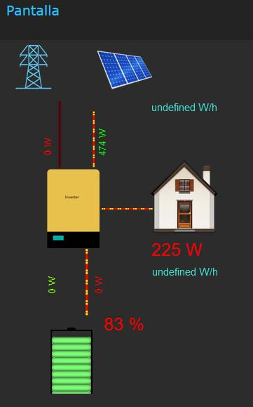

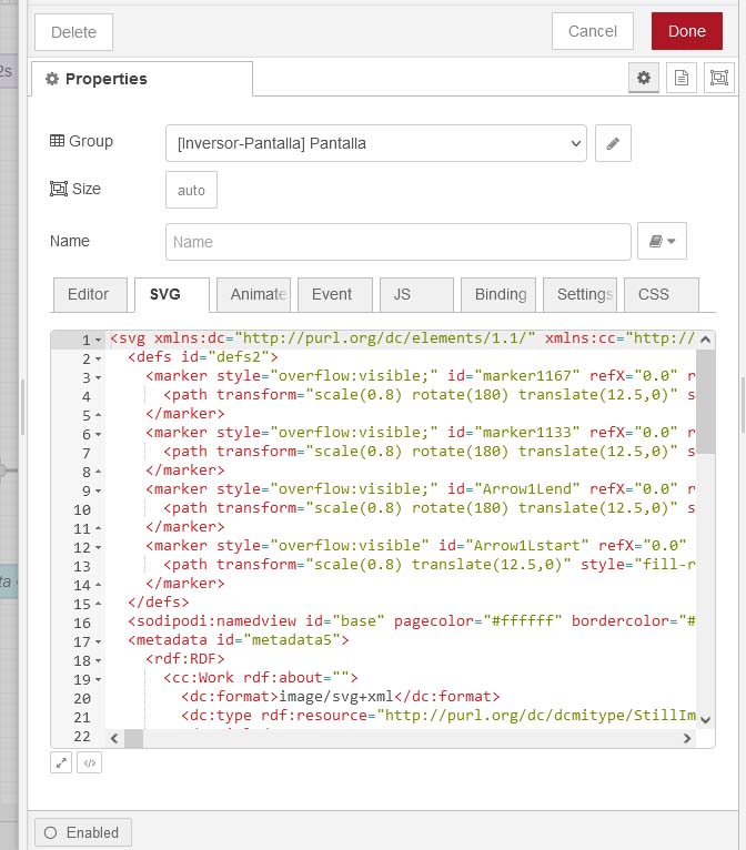

    Hay una cosa que no he visto... bueno no la he visto por ningun sitio todavia y creo que seria muy bueno para este tipo de instalaciones.
    Yo casi tengo practicamente toda una instalacion con este sistema y es un salto cualitativo y cuantitativo muy importante.
    Me refiero a introducir los sistema vectoriales en los dashboards tanto para control como para monitoreo. Lo de las grafiquitas y relojitos esta muy bien pero hace falta algo mas real... que se pueda ver y tocar. Y ahi entran los vectoriales.
    En la plataforma nodered hay un nodo llamado SVG (Scalar Vectorial Graphic) que usado adecuadamente obtienes un dashboard de los que yo llamo de la cuarta revolucion industrial en IoT que es ni mas ni menos que digitalizar los equipos que componen la instalacion.
    La instalacion total esta basada en un diagrama de cableado, es decir, algo como esto:
    Tutorial Monitorización Voltronic MAX, Nodered, Grafana...-digitalizaciondiagramacableado.jpg
    Ahora imaginad que los componentes, los wires, los leds, los interruptores, etc de ese diagrama fueran interactivos, es decir, se comportaran segun estan pasando las cosas en la instalacion y que con un click en alguno de ellos (o menu contextual) pudieras entrar en otra pantalla para ver en detalle o ajustar lo que fuera de ese. componente en concreto.
    Por ejemplo en un MAX se podria mostrar en dashboard la barra led tal cual esta manifestandose realmente. O incluso mostrar la pantalla del display digitalizada tal cual se ve realmente.
    Esto solo se puede hacer en entornos vectoriales con ficheros svg en donde cada forma representada es punterable y por tanto asignable un valor o funcion.
    En una foto svg no hay mapeo de bits como en una foto con pixeles. Los que hayan trabajado en diseño vectorial con Illustrator y similares saben de lo que hablo. Eso implica trabajar con ficheros muy livianos (es texto puro y duro) para representar los componentes de una instalacion en donde no hay perdida de resolucion como ocurre con fotos con pixeles a la hora de ampliar.
    La idea de monitorizacion es:
    1.- Mostrar al completo toda la instalacion con sus componentes tal cual se ven en realidad, leds encendiendose, apagandose y animaciones varias para que de un vistazo rapido veas que todo funciona con normalidad. Por supuesto si hay algun error o falla grave en ese dashboard de la instalacion completa debe mostrarse para que se vea donde esta el fallo, que es y porque ha ocurrido, todo en tiempo real. Un diagrama de cableado completo mostrando las potencias por ejemplo que circulan por los cables en tiempo real y con colorines de verde a rojo segun potencia circulante en el cable seria ideal para ver como esta funcionando todo... por ejemplo...
    Y si hablara ya seria ciencia ficcion.... o quizas no...
    2.- Clickeando cualquier punto o componente del dashboard de la instalacion completa que nos active lo que haga o que nos lleve a otras pantallas (otros svg por ejemplo) para mostrar mas detalles de lo seleccionado: relojitos, graficas, etc. que obviamente no se ven en el dashboard principal de la instalacion completa.
    Como lo veis???
    Pues que sepais que todo esto se puede hacer con la plataforma nodered.

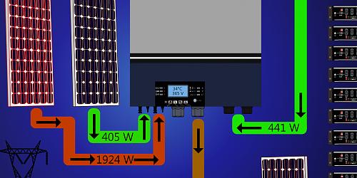

    Hombre Tejota, me alegro de verte por aquí de nuevo .... que sepas que parte de la culpa de este lío, la tienes tú ¡¡¡ ;-)
    Sobre los svg, si lo conocía, de hecho tengo una representación de un inversor y sus correspondientes flujos de energía entre la batería y la casa, como poder hacerse es completamente posible, y no funciona nada mal, permite hacer representaciones muy funcionales, incluso interacción con botones o zonas calientes etc... pero , es muy laborioso. Inicialmente, tenía pensado hacer una interfaz virtual del display del MAx, pero es bastante trabajo. Pero sin duda para una representación general de funcionamiento es ideal. Lo mismo algun dia me animo y retoma el tema ¡¡¡
    Bueno, todo es ponerse....
    Notese lo "rusientes" q se ponen las placas cuando estan produciendo "fuerte".
    En los svg todo es susceptible de monitorizarse. La barra led la estoy codificando...a ver que sale.

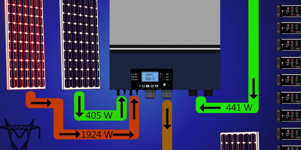

    Sin duda creo que este tema da para un hilo propio, de hecho abarca más de lo que parece, pues la representación gráfica, es un campo algo alejado en principio de los temas habituales del foro, y hay que empaparse del manejo de algunos programas para poder sacar el máximo partido a esta posibilidad.
    En su día estuve indagando un poco sobre toda en las posibilidades y hasta donde se puede llegar con esta herramienta, y encuentre que es posible hacer casi cualquier cosa que te plantees, es solo cuestión de dedicación y tiempo, se pueden representar incluso movimiento de flujo de energía intermitencias cambios de color y casi lo que se quiera.
    Pienso que hay dos formas de enfocar el asunto.
    Una ,llamémosla realista, que persigue una aproximación más parecida a la vista directa de los equipos, puede que más adecuada para el acceso a la instalación del resto de la familia ¡¡¡¡ ;D
    Y otra más sinóptica, o industrial , donde se representan los sistemas de manera menos realista, de modo conveniente para poder representar visualmente información y relaciones con diferentes elementos dinámica y más completamente que empleando relojes .
    También es posible hacer una mezcla de las dos, claro.
    Adjunto una imagen de las pruebas que realice, lo único destacable es el movimiento del flujo que acelera o se ralentiza en relación con el amperaje que trasporta, y cambia de dirección con la de la energía. El formato está adaptado para ser visionado en un teléfono. La posibilidad de orientar horizontal o verticalmente los números también da más juego que en otras representaciones.
    Algo interesante podría ser ir haciendo una pequeña biblioteca de gráficos para poder montar paneles de diferentes tipos.
Nombre: pantalla.jpg
Visitas: 64
Tamaño: 14,1 KB
    Pero en esa pantalla no has usado el nodo SVG no?
    Ese nodo es relativamente de hace poco https://flows.nodered.org/node/node-red-contrib-ui-svg
    No estan soportados todos los comandos para atacar un css pero si la mayoria. Por ejemplo las animaciones no estan soportadas de forma nativa, hay que inicializarlas en el nodo de forma individualizada. Styles, attributes texto etc si modifican directamente el svg.
    Despues ese nodo hay expresiones de atributo de estilo que no las reconoce y hay que cambiarlas por elemento de estilo. El autor ya lo ha señalado pero eso implica revisar los svg importados de la red y corregir ese problema ya que de lo contrario habra rellenos de otro color, concretamente del background por defecto.
    Animaciones como tal no estoy usando ya que implica doble trabajo. Queda muy bonito pero hay que picar mucho codigo. Eso ya lo dejo para los "pros".
    En cambio los cambios de colores si que lo veo muy interesante ya que el ojo humano percibe muy rapidamente un cambio de color brusco en un diagrama amplio. Y cuando hay cambios bruscos de colores es que hay cambios importantes en la instalacion.
    Cuantas veces se ha dicho, todo en verde.... eso indica que la cosa esta bien y sin "stress". En cuanto hay cosas rojas parpadeando, hay problemas o la instalacion esta entrando en "stress". Y si se ve que partes son las stressadas mucho mejor, sobre todo si puedes picar sobre ellas y ver que esta pasando con mas detalle.
    Que aparezcan y desaparezcan cosas es tambien interesante en el sentido de que por ejemplo si no hay Sol, las placas desaparecen de la pantalla. Idem si no hay red, la torre electrica que simboliza la red desaparece. O si no hay cargas, desaparecen los svgs q representan las cargas acoutput (neveras, bombillas, etc).
    El cambio de direccion de flujos en los wires de bateria son indiscutibles, yo lo hago con flechas segun direccion de la potencia q va por esos wires. Y si la potencia es cero, el wire desaparece integramente. TAmbien para wires de 230V exportada o importada.
    Creo que tendre que sacar un video en donde se vea con todo lujo de detalles esto. Pero el Spielberg me ha dicho que no tiene presupuesto para mi pelicula. xD
    Por cierto, no estoy usando el editor svg del nodo. Lo veo muy cutre. Tampoco illustrator ni lnkscape... son demasiado para estos graficos. Estoy usando un editor svg muy liviano https://boxy-svg.com/ . El svg resultante lo vuelco (es un archivo de texto) directamente en el nodo svg en la pestaña svg y asi carga perfectamente y sin errores.
    Claro que estoy usando el nodo SVG... si no la cosa no tendría sentido ...
    El tema de las técnicas para hacer notar un cambio o una condición de determinado elemento, como bien dices, puede ser simplemente con indicaciones de color y dirección, se trata de encontrar la forma de trasmitir la información con un esfuerzo técnico adecuado... que tampoco estamos haciendo la capilla sixtina. Yo también descarte él meto de animación que soporta el SVG, por la misma razón que tú , pero no abandone la idea e intente una aproximación diferente, utilizar gif, y funciono, no es tan potente, pero se puede utilizar sin tantas complicaciones.
    Yo tampoco uso el editor del nodo, empleo editores gráficos de toda la vida, Photoshop y Corel , después copio el resultado al nodo... creo que es la manera más fácil de trabajar con SVG y este nodo.
    PD
    Lo de publicar video me parece muy didáctico... pero me da una pereza tremenda... tengo que ver como capturo y edito después... etc No lo tengo en mi rutina habitual, y me supone mucho tiempo... pero puede que si termino haciendo algo que merezca la pena me anime ...
    Creoq ue es el mismo nodo ¡¡
