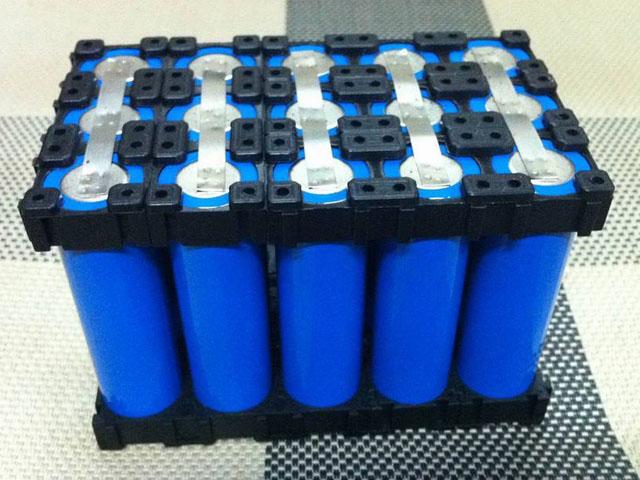

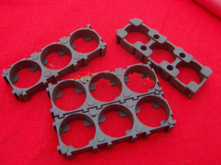

  20. #170
    Invitado Invitado
    Predeterminado Re: Y las baterias de Fe-Ni??
    Tambien nos podemos hacer nuestros propios holders de baterias d elitio de 3,7v
    Se venden en tente para conectar en serie o paralelo con adaptadores (no hay que soldar) te haces baterias a medida
    Cada bateria puede ser de 5 amperios a 3,7V de estas a 3 pavos unidad
    No digo que se puedan hacer baterias muy grandes pero para ir investigando no sale muy caro. Aparte se pueden comprar packs de baterias que en vez de unidades sueltas salen mas baratos
    2x UltraFire18650 3.7v Li-ion Battery 5000mAh For Torch /Flashlight B142 | eBay
    Fuente: http://endless-sphere.com/forums/vie...p?f=14&t=48746
    Concept:
    Build a battery that is easy to maintain and replace over time and involves minimal soldering. Go as green and cost-effective as possible.
    Source:
    Recycled laptop batteries.
    Technical Details:
    12 x 18650 batteries in series per bank at 4.2v per cell will come to 50.4v total.
    4 banks in parallel will estimate roughly 2 amps per bank totaling in 8 amps (conservatively)
    Materials:
    Clear acrylic scrap from Tap Plastics - $1
    Scrap romex and recycled car wiring - FREE
    6 x 18650 Case Holder on slow boat from China - $1.45 each
    http://www.buyincoins.com/new_en/det...duct-9164.html
    The Layout:
    The Layout
    Soldering in Series:
    (214.55 KiB) Downloaded 6 times
    1/2 Complete and not yet fully charged:
    Underside to contain future banks. Note the nickel plated contacts for slide-in/slide-out function:
    Testing:
    My tests were not performed on a full charge, nor is this a full 4 bank battery. I've only run it on 2 banks, but my 48v 1000w hub motor still was able to pull me from a dead stop and accelerate to about 20+ MPH. I look forward to a full charge and will use my GPS to calculate speed and distance for only 2 banks. I'm currently still looking for more ewaste stashes of laptop batteries, so I don't have a reason to complete the other 2 banks just yet, but more testing to come.
    Archivo adjunto 8022
