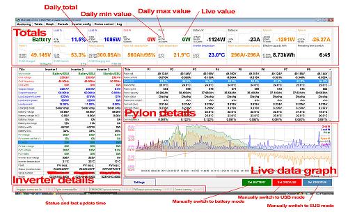

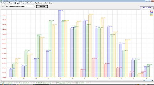

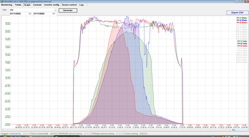

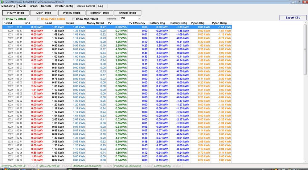

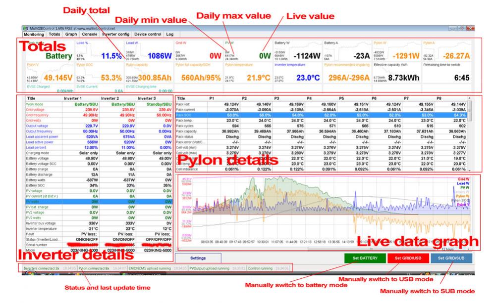

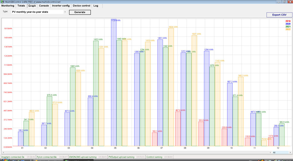

    Aqui hay un software gratis...
    MultiSIBControl is a software tool for monitoring and control of PIP/Axpert inverters and Pylontech batteries.
    MultiSIBControl 1.8 is available for download. Please everyone update to the latest version as older versions will expire on 31/12/2023!!!
    Este es el enlace: http://www.multisibcontrol.net/ .
    MultiSIBControl - Monitoring an dcontrol for Axpert, PIP, Pylontech, Pylon, PIP4048, PIP5048, Voltronic
    MultiSIBControl software offers the following functionality:
    - read and display data from one or multiple/parallel PIP/Axpert/Infinisolar/Voltronic (and compatible) solar inverters using USB or RS232 communication
    - read and display data from Pylontech batteries using RS485 or RS232 console (preferred as it supplies more data with better precision)
    - handle 2 separate stacks of Pylontech batteries (up to 2x16 units) without need of HUB
    - control inverter work mode based on time schedule
    - control inverter work mode based on Pylontech SOC
    - control inverter work mode based on custom conditions (in Device control)
    - control inverter charge mode based on time schedule
    - control inverter max charging current based on Pylontech BMS data
    - control web/ip devices (by sending web requests) based on custom conditions (in Device control)
    - send notifications to your mobile phone by using web push notifications service (in Device control)
    - read and display data from web/ip devices. Currently possible to read data from OpenEVSE, Shelly EM and Shelly 1PM
    - send data to emoncms server
    - send data to PVOutput
    - store RAW live data from inverters/batteries into database and generate reports (2-4GB of disk space per year). Up to 10x inverters and 32x batteries.
    - generate various reports using raw/hourly/daily/monthly/annual data from the database
    - export CSV data
    - local web server for live data monitoring and control of inverters' mode
    - ability to pull live data from other apps/tools using the local web server
    Requirements:
    - A computer that runs Windows XP, Windows Vista, Windows 7 (32/64), Windows 8/8.1, Windows 10, Windows 11
    - Microsoft .NET Framework Version 3.5 (or a newer version). Free, available from www.microsoft.com.
    - USB or serial inverter connection cable
    - RS232/console and/or RS485 Pylontech connection cable
    - Approximately 2GB storage space per year for the database
    - 1.5GHz CPU and better recommended .
