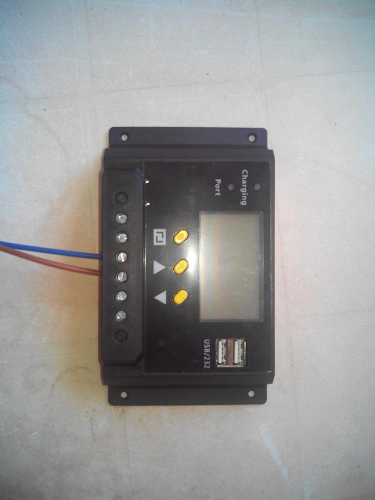

3.11 Review and setting the load mode
As shown at the right figure, it is the reviewing surface of the load mode. Different numbers represent different load modes:
24h = indicating normal mode, loads are under the condition of supplying power without breakdown
1h~23h = indicating delayed mode of light control, loads start to supply power after dark and shut down after working for the delayed setting hours
0h = indicating light control, loads start to supply power after dark and stop working after down
At this interface, press button [] for long (>5 seconds), the number starts to flicker, and it means the controller enters into the interface of setting the load modes. Use buttons < and > to adjust this parameter. After finishing setting, press button [] for long (>5 seconds) to exit this interface and the controller can store this setting number.
