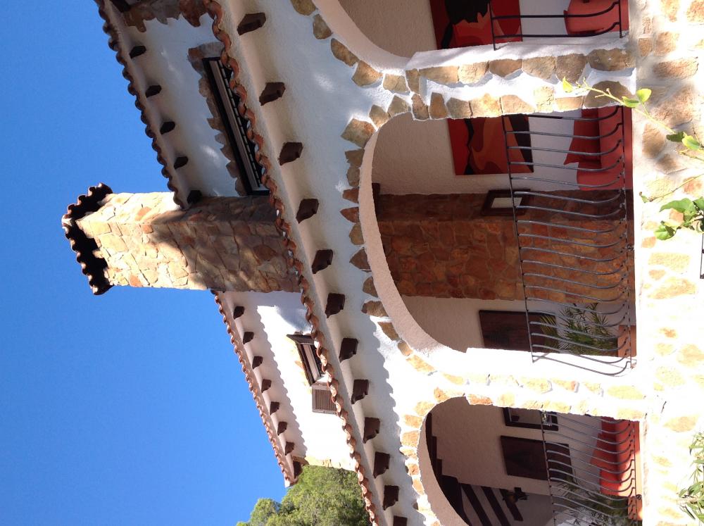

The insert went in where the woodburner was before, the exhaust pipe only goes up about 1,5 meters into the chimney, and there used to be a plate sealing the chimney just behind the pellet oven but that was destroyed when they came to clean the stove a year ago.

Behind and above the pellet burner, inside the chimney it gets very very hot!

Pictures of chimney and room. Sorry for upside down pictures.
